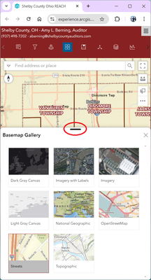

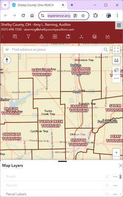

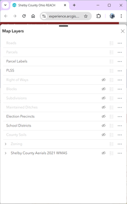

Is it possible to make calcite-dialog like Widget Windows in ArcGIS Experience Builder?
https://experience.arcgis.com/experience/42818c03ae384edc91ab658faf2664e0

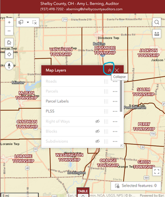

1. Add collapse button in calcite-dialog
2. Make calcite-dialog responsive like:
Thanks.

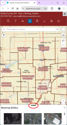

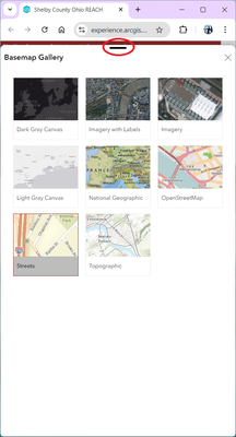

I think what I want is calcite-dialog can be resized like this way in Mobile/Phone:
Any idea how to do it?
Thanks.
Forrest
