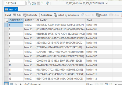

HusseinNasser2
Just did a quick test on 2.7 and seems to be working
created two point classes testfrom and test
created a bunch of features in testfrom
created a sequence + AR above on Test class
executed an append from testfrom-> test and the resulting AR got executed as expected.

I'll give it a second try then; maybe it's 2.6 thing.  I'm late in updating...
