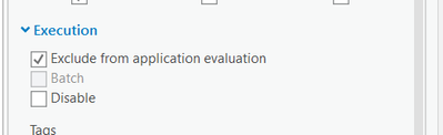

Zoggo,
Yes. Your code looks fine, the issue may be that the attribute rule is not configured in a way to allow it. Do you have the Exclude from Application Evaluation parameter checked?
This allows the application to see tables not present in the service. This is outlined here

Zoggo
That works for me. Thanks a lot!
