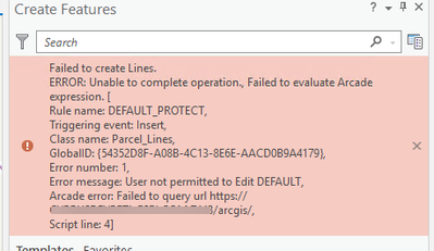

When using the Arcade Portal() function I get the following error.
I can copy and paste that URL into the browser of the environment and access the Portal.
Any thoughts? Below is the code, it's a very basic constraint rule copied from the video here the URL and group name are the only things switched out.

UPDATE:
This is a known bug introduced in 10.9.1 and is scheduled to be fixed in a future patch.
HusseinNasser2
Bug can be tracked here BUG-000151193
