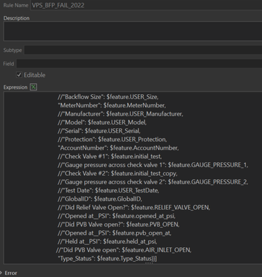

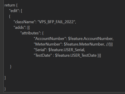

Trying to log edits to a layer to a table. It works with some fields, it fails with others with the following error:
Here's my code:
Any clues?
TIA

I get this error if I supply wrong field names. In your case, Arcade could not find the field "serial" in "VPS_BFP_FAIL_2022".

Strange, because it's all there, alias properly spelled, field name brought in from the expression builder, not typed. Only three fields work. The rest throw the out of index error except OBJECTID and GlobalID throw the field not editable error.
See, there's your problem. You need the real field names, not the aliases.
