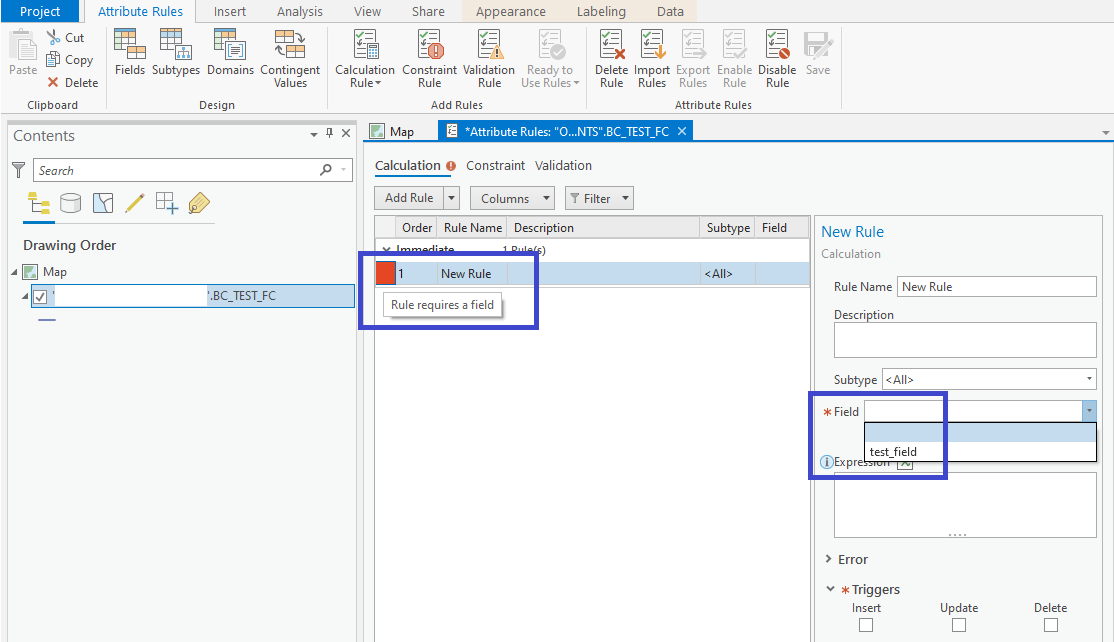

I have a calculation attribute rule that updates polyline geometries: Set polyline M-values to cumulative length of line. That attribute rule works as expected in ArcGIS Pro 2.9.2 / FGDB (test environment).
Now, I want to use it in our 10.7.1 EGDB and ArcGIS Pro 2.5.0 (production environment).
When I go to create the rule, I notice that the Field is mandatory, yet the SHAPE field is missing from the field list:
(That's different than 2.9.2 -- the field isn't mandatory in 2.9.2, and the SHAPE field shows up in the list.)
If the Field is mandatory in 2.5.0, and the SHAPE field is missing from the list, then how can I create an attribute rule that updates the geometry?
Thanks!
JohannesLindner
MVP Alum
These were changes made in 2.6 (geometry updates) and 2.7 (update multiple fields). Arcade and Attribute Rules are under active development, so sadly, something like this is bound to happen now and then.
In 2.5, you can't.*
You'll have to update your production environment. Pro 2.7 should be enough for your rule, but go take a look at the Arcade Release History, maybe there are some functions you want to use from later releases. Combined with the Arcade Version Matrix, this will tell you the versions of Pro and Enterprise.
