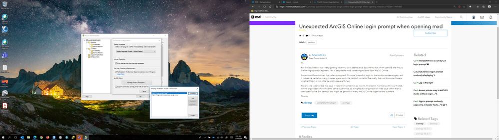

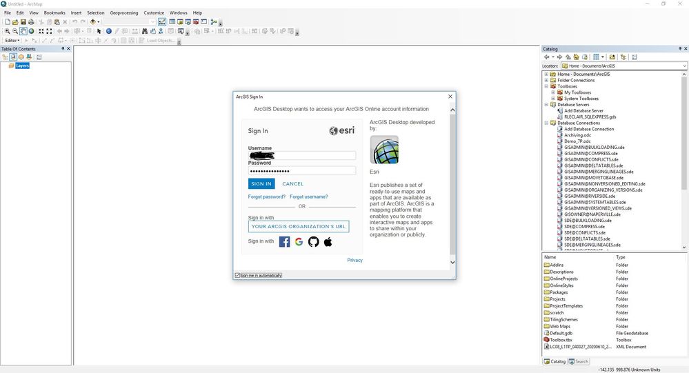

Rafael - so two questions for you.  If you go to the Windows Start Button -> ArcGIS -> ArcGIS Administrator ->Advanced -> Manage Portal Connections, is your active portal set for https://www.arcgis.com?  Second, when you start ArcMap, click File-Sign in with your username/password credentials AND make sure the check box for "Sign me automatically" is checked.  See below graphics.  This "should" stop the behavior you're seeing.

Thank you for your message. To the first question, yes, it's set to www.arcgis.com; to the second, no, the check box is empty. I have changed it now to sign in automatically so hopefully that will sort it?
