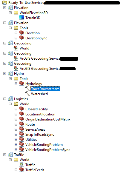

I just experienced this while working with a client with same symptoms.  It turned out that the mxd had references to AGOL ready-to-use services, and once signed in, these appeared in the Catalog pane:
ArcGIS Online Ready-to-use servicesArcGIS Online Ready-to-use services
(I had never used any of these previously, I didn't even know you could use AGOL like this in Desktop)
As mentioned, you can also hammer Cancel enough times to not load these.
Strangely enough, and of some concern to me, these are now seemingly irrevocably attached to my account.  I cannot remove them from either the mxd (even when saved as copy or imported into Pro) and any time I sign back in to Esri Online, they reconnect.  Thankfully they do not appear to be propagating to new mxds, perpetuating the annoying sign-in cycle.  It would be nice to know how to get rid of them seeing as I do not do analysis like this (I would use ArcPy or local GP Tools) and they apparently consume AGOL credits.
