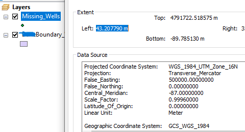

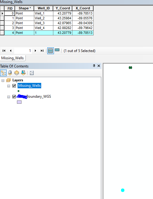

Everything appears to be working correctly, the data table and attributes are correct, the newly added points appear to be correct relative to one another. The issue is when I try to update an existing file. The newly added points are way off somewhere else. In the example here, I tried to add the exact same GPS coords (in decimal degrees) as an existing point. You can see the first entry, the Y_Coord and X_Coord for Well_1 is the same as 1. However the new point is way below the other points.

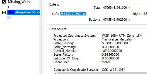

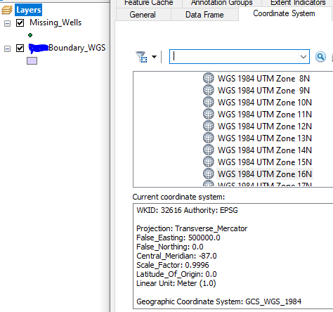

Immediately, I am thinking this is a coordinate issue of some sort, and searches on the problem indicate a coordinate issue as well but I have a million-times checked to make sure the shapefile, a boundary layer (visual check only), and dataframe are all in the correct geographic and projection coordinate systems. GCS being used is GCS_WGS_1984 (WKID: 4326) and PCS is WGS_1984_UTM_Zone_16N (WKID: 32616).
I have double-checked, triple, a million times checked to make sure the coordinates systems are correct. I have tried to specifically assign it in Python (although I am not sure I am calling it correctly.

Your coordinate system is UTM Zone 16.  SHAPE@XY will be expecting a tuple of UTM cartesian coordinates.
Can you check the coordinates of your new point in ArcMap - you'll likely see it about 100m from the UTM origin.
I'd also run a search cursor to print out the SHAPE@XY values and you'll be able to see what's going on.

I see what you're saying here. How do I correct this? I tried switching the projection to Web Mercartor (WKID: 3857) but that didn't fix it either. What projection should I be using if I want the input data as decimal degrees? Or should I not be using the SHAPE@XY at all and be using a different tool?
