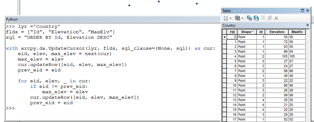

What results/anomalies are you getting (screenshot)?
Think Location
badrinathkar
Sir, please see the attached figure.
JoshuaBixby
MVP Esteemed Contributor
I see you have an "FID" field, I am assuming you are working with shape files.  If you consult the documentation, UpdateCursor—ArcMap | Documentation (arcgis.com)
DISTINCT, ORDER BY, and ALL are only supported when working with databases. They are not supported by other data sources (such as dBASE or INFO tables).
In short, my approach won't work for you because you are working with shape files.
