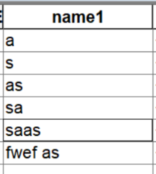

Dears I am trying to replace text in a field, I want to rematch English alphabet into Arabic alphabet like (a = ش, d = ي, s = س, etc...). I wrote a test script for 2 characters and run it in ArcMap 10.8 python window, it doesn't works well as it is work with English alphabet:

dears i'm trying to replace text in field, i want to rematch English alphabet to Arabic alphabet like (a = ش, d = ي, s = س, etc...). I wrote a test script for 2 characters and run it in ArcMap 10.8 python window, it doesn't works well as it is work with English alphabet: here's my script: my data enter image description here

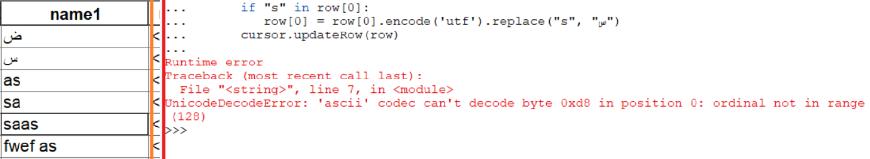

Output/result

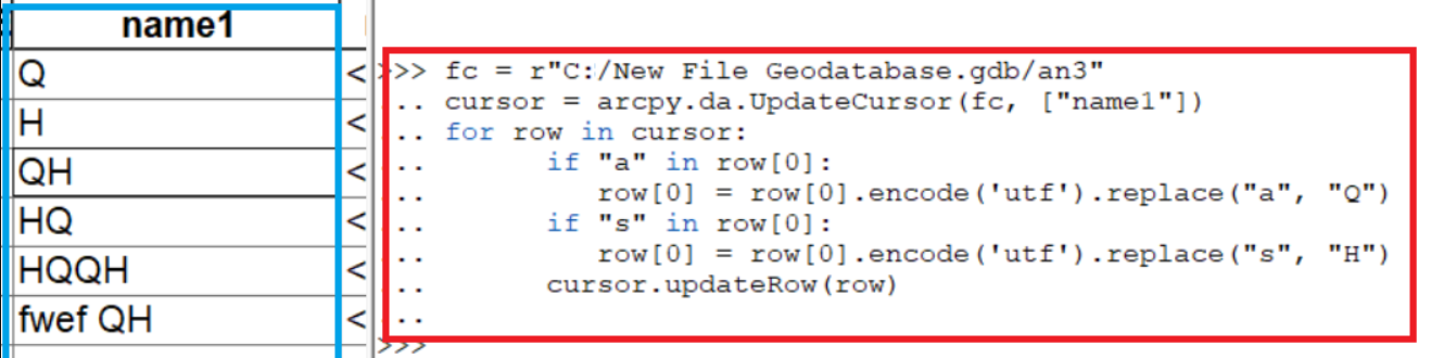

test script with English alphabet instead of Arabic on the same data:
fc = r"C:/New File Geodatabase.gdb/an3"
cursor = arcpy.da.UpdateCursor(fc, ["name1"])
for row in cursor:
      if "a" in row[0]:
         row[0] = row[0].encode('utf').replace("a", "Q")
      if "s" in row[0]:
         row[0] = row[0].encode('utf').replace("s", "H")
      cursor.updateRow(row)
 Output:
it works fine with all characters in all cells.

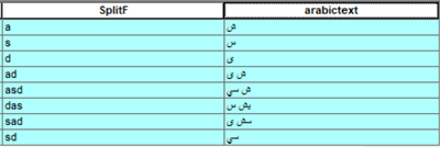

In Field Calculator, I used VB Script Parser with a similar expression.
Replace(Replace(Replace( [SplitF],"a","ش " ), "d","ي"), "s","س")
The result looks like this
Is the above output correct?
