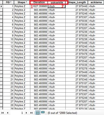

I have two different field with different properties as can be shown from photo.
I need to copy one field  properties to another becaure there are more than 2000 rows.
When I try it gives error "The value is you entered is out of range or is not a whole number"
First field type is double second one is float. Thanks for answer.

If column2 needs to be long, then you will lose the decimals when the copy is made.
And you would have to do
int(column1)
to do the rounding.  If it was float, then the decimal values would copy over unless there was an overflow caused by the reduction in field type.

Did you just try a simple field calculation such that yukseklik calculated using Elevation as the value field to use

As far as change of Field type of an existing field is concerned, you can't do it for a non-empty table.
You may delete the existing field (with NULL value), and create a new one with same name and the desired fieldtype.

 I need to copy column 1 to column 2.  I cant edit column 2 field type   it should be long type.
int(column1)
Did you try any of the suggestions?

thank you for answer. I havent use before field calculator. As I know in order to copy one to another, both fielld type should be same.
 elevation(column 1) field type is  double
yukseklik(column 2) field type is long
 you wrote "int(column1)"   be used in  field calculator? thanks .

Thaks Dan,  I tried just before it works!
