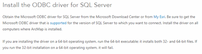

I think every machine running ArcMap has to have the appropriate SQL Server drivers installed. Back when this was happening to me installing the SQL Native Client installed the drivers I needed (that was 4 or 5 years ago), but maybe today its just an SQL driver you get from Microsoft... about half way down the page is the title:
I would try installing the recommended SQL Server drivers again on the problem machine... maybe something has gone wrong with the drivers installed there already.
