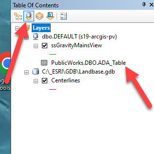

List by source will show you all layers AND tables that are currently loaded into your map document (image show View, Table, and Feature Class):

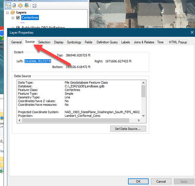

You can right click the layer in ArcMap, properties, source tab to show you the layer/table name/location:
If you have joins or relates, you can look in the Joins and Relates tab to see what tables are joined or related:

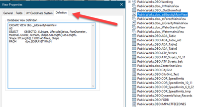

For views, you can find the data location in the source tab, then get properties in ArcCatalog, the definition will show the SQL that creates the view:

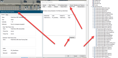

And if you have relationship classes set up in the database, you can get that info from the Relationships tab in the properties in ArcCatalog.
