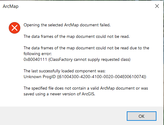

When opening a specific map document in ArcMap and prompted to login to ArcGIS Online some users are getting the following error:
Once you click ok, you just get a empty mxd open. I can open it with my ArcGIS Online credentials but with another users ArcGIS Online details it doesn't work. We have tested this with a few different credentials on the same computer and some work and some do not. All users have ArcMap 10.7 and Creator level ArcGIS Online accounts. Any advice on what could be causing this?

I did some quick research into this error message and I see a bug (BUG-000115674) that's logged regarding this behavior.
The bug is tagged as In Product Plan, so there will be a fix pushed out at some point however I am not sure when that date might be. Apparently, map documents will fail to load and they will return the received error if a layer within the document references a feature service that has been overwritten.
Can you confirm whether or not the .mxd that throws this error message contains any kind of Feature Service coming from ArcGIS Online or ArcGIS Server?
I would recommend that you reach out to Esri Support Services to have this message investigated. If it is deemed that you're encountering the bug I am looking at, Support may be able to offer you a workaround.
