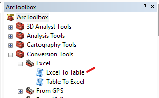

Sean_Wray
Try saving the file as a .xls file and format the fields just as you need them. Then open the conversion tool box > Excel and try using the Excel to table tool.
Is it possible for you to upload your excel data here?
