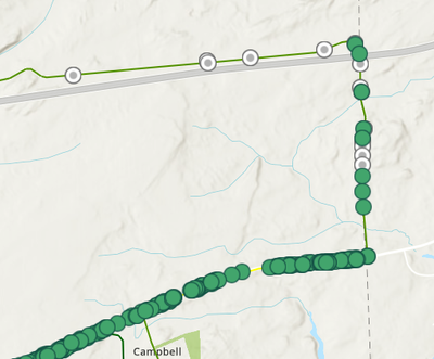

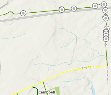

I'm seeing the same issue as above. Was this ever addressed? My Workforce application has 20,000+ records in it and I don't want to show completed assignments in order to simplify the project.
Here's my Workforce project:
Here's the Dispatcher map preview:
