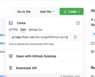

You can directly download it from Github using the "Code" button and choose "Download Zip".

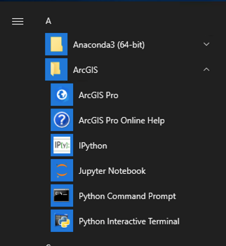

You need to run the script from the command-line not from the built-in Python Interpreter in ArcGIS Pro. So open "Python Command Prompt" from inside the ArcGIS folder. This will activate the correct conda environment for you.

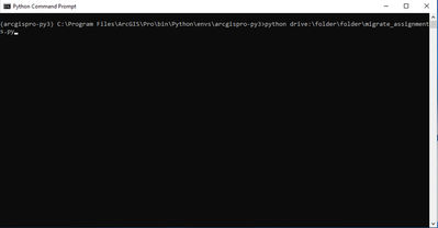

Then run the script there (after putting in all the parameters):
