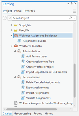

We use the Python API and create an ArcGIS Pro toolbox that through an excel, txt, csv, etc. handle assignments. see the picture:
