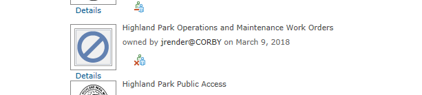

Had a user that was deleted from our Portal before removing from Workforce. Used the rest endpoint to delete the 'ghost' user, but still cannot get the users tab to load in Workforce configuration mode. Says found error 'groups is inaccessible' via dev tools (see image above). Any ideas?

Looking at the HAR file; I see an error indicating an issue with the Workforce Group.

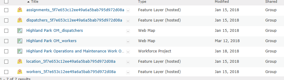

Can you confirm whether the Group that was created when the Workforce Project is still available and has not been deleted?
Craig
MCAGIS
Seems to still be there. Is there a way to fix the issue? Can i recreate the group, and share the items with it again?
MCAGIS
we are still using the project, but cannot add new employees. It is still functioning.
