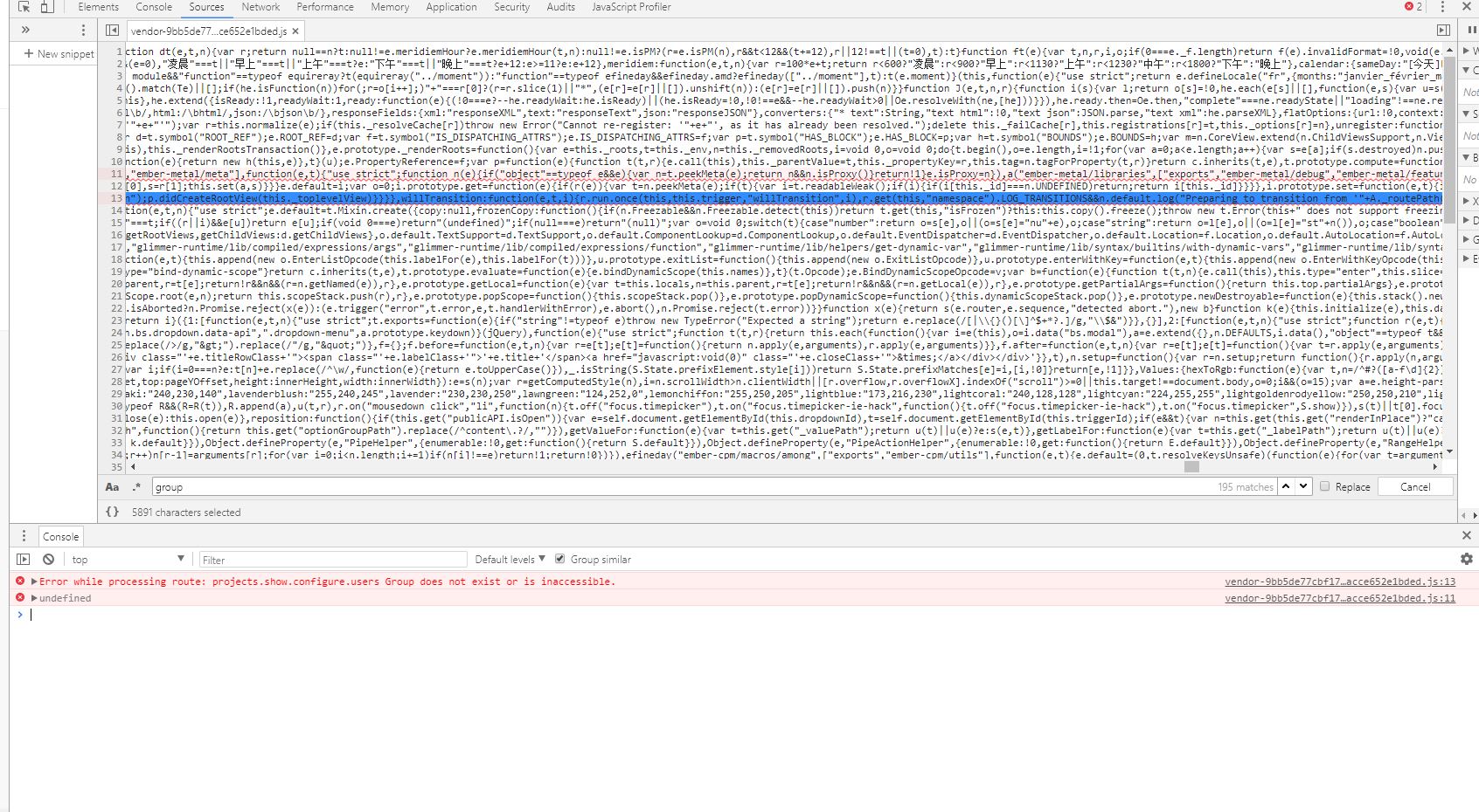

Had a user that was deleted from our Portal before removing from Workforce. Used the rest endpoint to delete the 'ghost' user, but still cannot get the users tab to load in Workforce configuration mode. Says found error 'groups is inaccessible' via dev tools (see image above). Any ideas?

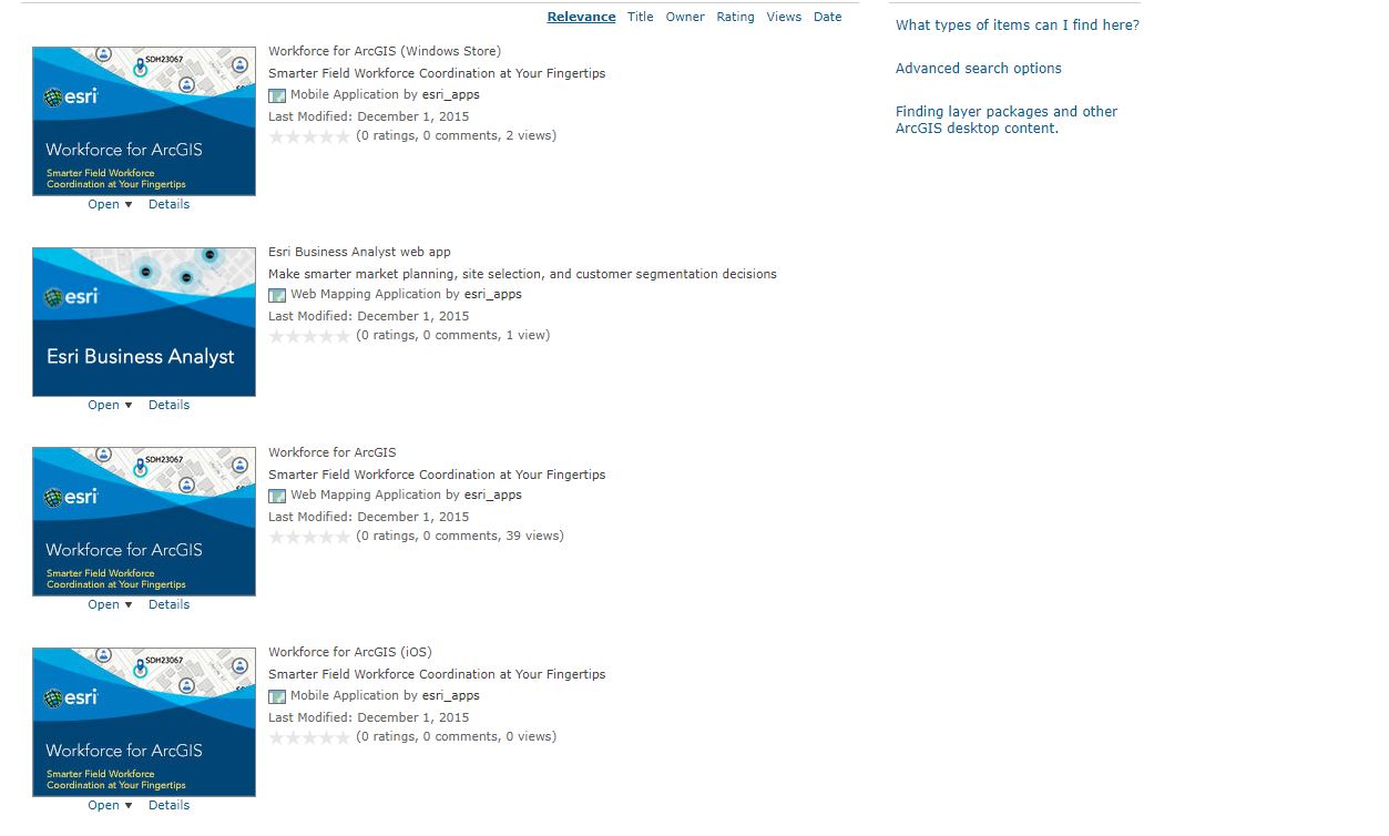

Not sure how to check the Workforce version. This is what I see in the items details:
Details
Created: December 1, 2015
Shared with: Everyone (public)
API: JavaScript
Purpose: Ready To Use

Ok, one easy way to determine the release of Workforce is to look at the list of Apps/Programs installed on your Server.  The version of Workforce should be included in the title.

Our IT says it is the latest version available (1.5). But not sure that makes sense. Let me know if that sounds correct.
CraigGillgrass
Unfortunately, no - we didn't release a version of Workforce with the 1.5 version number.  We updated Workforce for Enterprise (this is our 17.0.1 release) at the end of November.  We addressed the issue of the Users tab crashing in this release.
Let's go at this a different way - can you use Developer Tools in Chrome to capture a HAR file?  We need the log for when you click on the Users tab to dig into the error.
