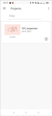

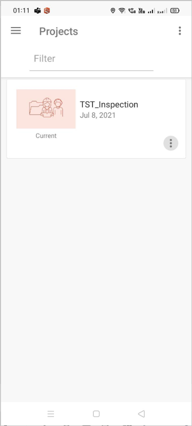

I created a project in workforce web application  and tried to login with worker credentials in Mobile app ,
1. in Old Mobile application Workforce for ArcGIS we can see the project which i created .

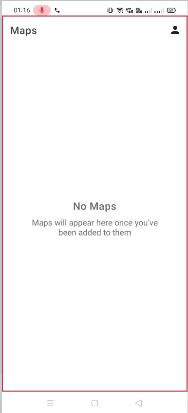

2. in New Mobile Application ArcGIS Workforce  i couldn't see any projects which i created  in web workforce.
could you please help me out for this issue

Hello @Jagadeesh Are you using ArcGIS Enterprise and is it version 10.8.1?  Or are you using Online?
Jagadeesh
@CraigGillgrass ArcGIS Enterprise version 10.8.1
CraigGillgrass
@Jagadeesh please see this section of the doc under "How do I get the app?"
https://doc.arcgis.com/en/workforce/faqs/faqs-general.htm
