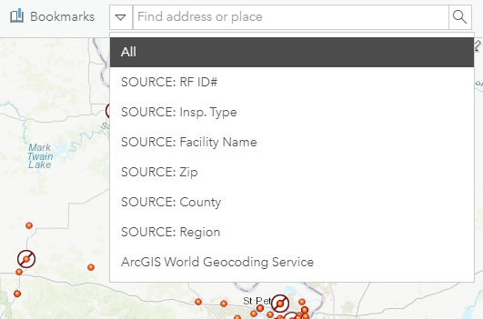

Attempting to duplicate the process in this example from a few months ago.
I have configured my dispatcher map to be searchable by layer:

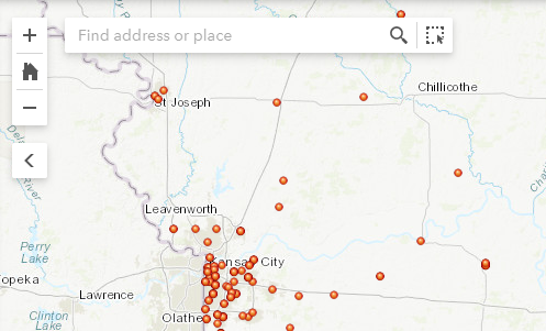

However, my dispatcher map within my Workforce project does not appear to be searchable by feature layer as I've defined it:
Is there a second step to make my layers searchable in Workforce, or is this no longer a capability?
JeffShaner
Hi Konrad,
The Workforce web app will execute the feature search you set up in the web map, however it does not provide you with any search suggestions nor does it provide the drop down that lets you determine what layer to search against (like you see in the Map Viewer app). This is being considered for a future release of Workforce.
Thanks for asking the question and for your feedback!
Jeff
