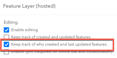

@BrianMcMills  Is there any chance someone turned off editor tracking for the feature service? The "editDateField" is a property on the layer that is checked by the Workforce web app and it appears that is undefined. It can become undefined if editor tracking was disabled on the layer. You can check this by going to the feature service item details page -> Settings tab.

Hi Aaron,  This was it, we had removed the check box the other day. I checked the box again and the Project was fine after that.
Thanks for the response, it was a big help to us.  I will remember not to do this in the future.
