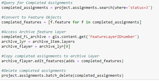

by Anonymous User
Not applicable
Hi
Thanks for the tip on converting to features - I knew I was missing something!
I did need to add another bit of code to actually add the completed features to the archive layer. I had to change from Feature Layer Collection to Feature Layer to be able to use .edit_features() command. I'll attach the code that finally worked for me. Thanks again!

by Anonymous User
Not applicable
Hi
Kman
Hello all,
This looks like a great solution that could aid others in managing Workforce assignments.  Unfortunately the final version (which includes the Feature Layer Collection to Feature Layer to be able to use .edit_features() command)  of the code was not posted.
Anyone have a similar sample they would be willing to share?
Kman
Quick update and big props to AaronPulver for pointing out my error.  Here is version of the code which will allow you to move completed assignments to a separate feature layer (archived) .
# connect to org/portal
gis = GIS(orgURL, username, password)
project = workforce.Project(gis.content.search("type:'Workforce Project' 'name of WF Project'")[0])
#Archive Hosted Feature layer item ID (Note-The index "0" means the first layer in your feature service, so if you service has multiple layers, you may need to change that.)
completed_archive = gis.content.get("d25ed4b313bd499994b4727a6584a22213").layers[0]
#Query for Completed Assignments
completed_assignments = project.assignments.search(where= ' status=3 ' )
#Convert to Features
completed_features = [f.feature for f in completed_assignments]
# add features to layer
completed_archive.edit_features(adds=completed_features)
# delete assignments
project.assignments.batch_delete(completed_assignments)
