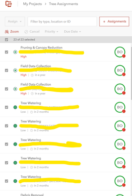

@CraigGillgrass I can't re-assign or edit "In Progress" assignments.
For example:
Also, if I select all assignments by this user, all other buttons become grey, can't edit anything.
The old user has already left the organisation. If we re-assign his job to another user. In the future, when we recheck job history, it might cause issues. Are there other ways to remove them from the Workforce?

CraigGillgrass
You'll need to make these changes outside of Workforce through Map Viewer.
"In the future, when we recheck job history, it might cause issues. Are there other ways to remove them from the Workforce?"
There are not.  Your only alternative is to leave the assignments as is.
