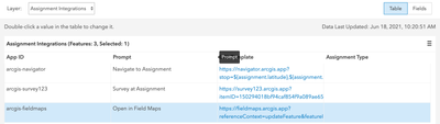

      4. Double click URL Template field and you can paste in your url.  I attached a screenshot of one of my projects.Screen Shot 2021-06-18 at 10.27.20 AM.png
