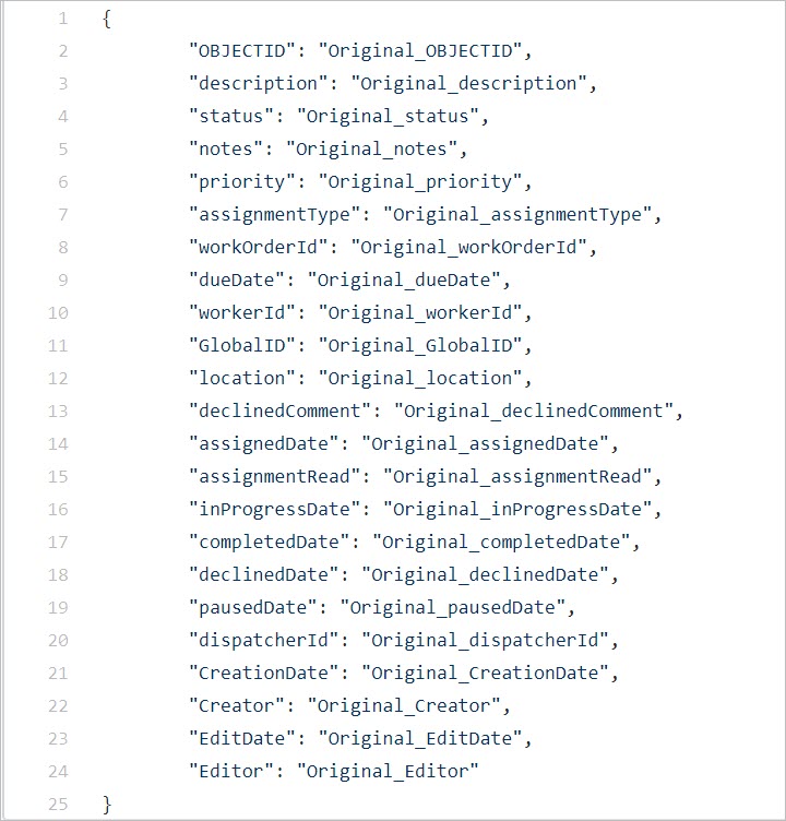

This script uses a JSON configuration file (shown below) to map the assignment layer field names to those in the target feature layer. The field names on the left belong to the assignments layer, and those on the right belong to the target feature layer.
Default configuration file
When creating the target feature layer, use different field names to distinguish them from the assignments layer. If you don’t want to edit the default configuration file, name your target fields “Original_” followed by the original field name (shown above).
It’s important that you create a new OBJECTID and GLOBALID field in your target feature layer (named Original_OBJECTID and Original_GLOBALID, respectively). Since these are system generated fields, you may encounter duplicated values if you don’t create new fields. The Original_OBJECTID field should be an integer value, and the Original_GLOBALID field should be a string value.
Note: If your target feature layer has different field names than those shown above, edit the configuration file to match your target field names. Then save the file.
