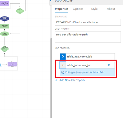

hi, I'll try to be clearer. I'm working with WFM server version 10.9.1. As you can see from the first attached figure, I defined an extended property by linking it to a table.
I am able to read the content in the steps and in the paths, but how can I change it with one step?
Using Update Job Properties step (as you can see from the second figure) a message tells me that I can only modify the linked field. So my question continues to be: how can I change the content of an extended property of this type, using one of the WFM server step ?
Thanks
Gianmaria
Gianmaria,
Workflow Manager only allows you to associate the job with the feature layer by using the linked field configured in the job template. In Update Job Properties step, by entering the linked field value, the job is associated with the corresponding record in the feature layer. You will not be allowed to edit any other fields in the feature layer than the linked field. I hope this help clarify your questions.
