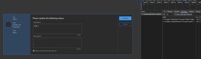

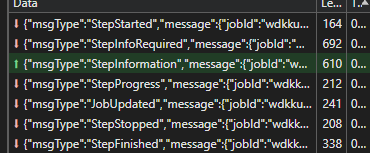

When you run an Update Job Properties step (I'm demoing in the web application here for simplicity), you should see both step started and step info required messages
When you add in your values and send proceed, you should then see these messages below, starting with the step information message which is the update that you sent.
Our WebSocket Message API has the information you're looking for on what to submit to the step. Specifically, this is what you'll need https://developers.arcgis.com/workflow-manager/api-reference/web-sockets/#message-updateJobPropertie...

Thanks to @JFarmer, this is now working.
You need to use the WebSocket, I used the native WebSocket (not the ESRI Notification Manager).  I also used a Node JS Test Harness to debug the WebSocket connection setup and get it stable.  This removed my ArcGIS Experience Builder - Dev configuration from the debugging process.
Some lessons (these may have just been my implementation):
  1. Don't try to subscribe to all jobs, instead load the jobs from a REST call and subscribe to specific jobs.
  2. When updating the Step Information, make sure to Start the step and Stop the step when you have finished.
  3. Don't try to do too much at once (this is more for me 😊), focus on the required functionality.
  4. Use the ArcGIS Workflow Manager UI to help with the messaging patterns and expected payloads (this was super critical).
