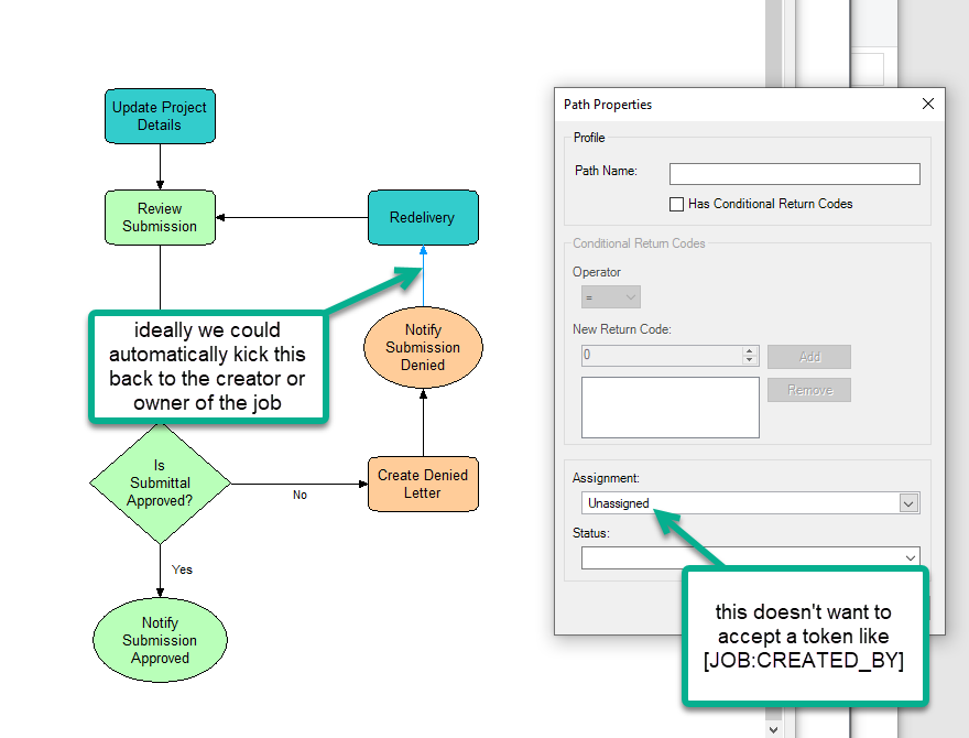

Hello!
We are setting up some job types for our record drawing processes and there's a case where the job should be reassigned back to the person that initially submitted it.
Is there a way to do this automatically?
I did try entering the [JOB:CREATED_BY] token into the path properties, but it didn't want to let me save that --- wondered if there was another way to do that?
thanks for any tips you've got!
jess
MJames
Hi @jessneuner,
We have achieved what you described by using an assign job step which is set to auto execute. The step is parsed the token as an argument/parameter. It would be nicer to be able to reassign a job using tokens on a path however I don't think this is possible. Maybe this should be raised as an idea.
Hope this helps.
jessneuner
Thank you!
