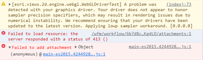

I think I didn't get the right level of error previously. The errors below are more relevant to the action I am trying to do and it might lead to confirm my hypothesis about the file being attached is too large.
Is there a limit on how big of a file that can be attached in WM Web App? Is there any way to change the size limit?

After a series of my own testing, it seems that files with the size of around 10 MB seem to pose no errors. Is this the limit for attaching files in WM?
