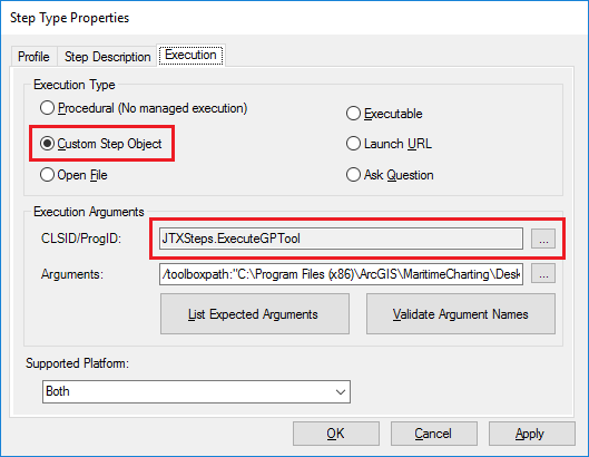

I've created a custom step in Workflow Manager Administrator. The custom step is executing JTXSteps.ExeucuteGPTool, like so:
The arguments are:
/toolboxpath:"C:\Program Files (x86)\ArcGIS\MaritimeCharting\Desktop10.6\ArcToolbox\Toolboxes\Nautical Tools.tbx"
/tool:ExportGeodatabaseToS57 (this is the only one required)
When I press the Validate Arguments Names button, I get this

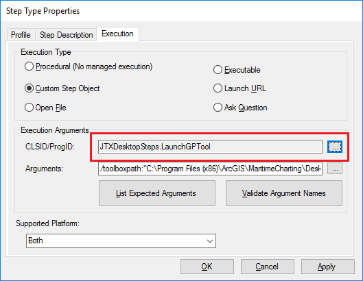

Even if I only use the /tool argument. If I instead of the JTXSteps.ExecuteGPTool use the JTXDesktopSteps.LaunchGPTool, like so:
And press the validate-button, I get
Anyone experienced this? I can't get the step to run if I use the ExecuteGPTool, and I don't want the GP Tool dialogue to show, so the LaunchGPTool is not an option.

Try configuring with the launch tool to get it all right, then switch it back to execute.
This is what I do, because I get that error as well.
Hope it helps.
