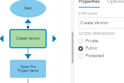

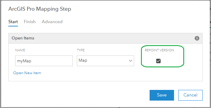

We are using ArcGIS Workflow Manager Server (service-driven). We have created simple workflow diagram using "Create Version"(Public) & "Open Pro Project Items" (configured "myMap" as Map & Repoint Version).

When we execute the job in ArcGIS Pro, able to open "myMap" but the feature service is still pointed to the child version i.e. "Job_1". even though we are executing the Job_2.
Is this the expected behavior? or bug?
