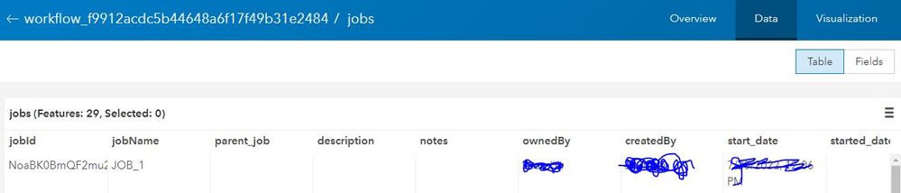

    • Each workflow item created creates 3 separate files in your Portal. One of those files is a hosted feature layer that you can use to access all of the underlying tables and data (go to the item page in Portal and click on the Data tab).

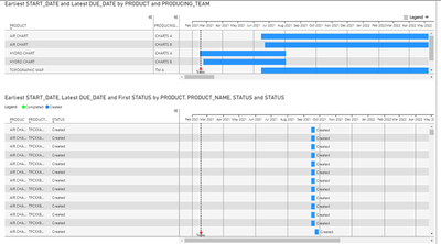

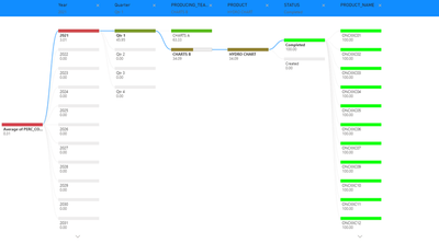

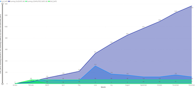

I have included some PowerBI screen shots, as an example only, the information is coming straight from the workflow manager database (using a direct connection to an enterprise geodatabase) and is updated when operators utilise workflow manager.
