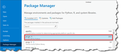

Check Python API library:
  1. In Pro, go to File -> Package Manager and look for the arcgis package to check the version. If it is at 1.9.x then it will need to be upgraded to 2.0.0 or higher.

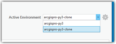

2. Ensure you have created a clone of the Python environment in Pro

6. When this completes, close and open Pro (if it was open during the update) and check the arcgis library in the Package Manager. It should be updated to 2.0.0.
