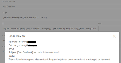

Hi all,
I am trying to use Arcade expressions in Email Templates for 'TO' and 'CC', but the Arcade expressions are not returning any values, although the same expressions work as expected when used in Send Email step.

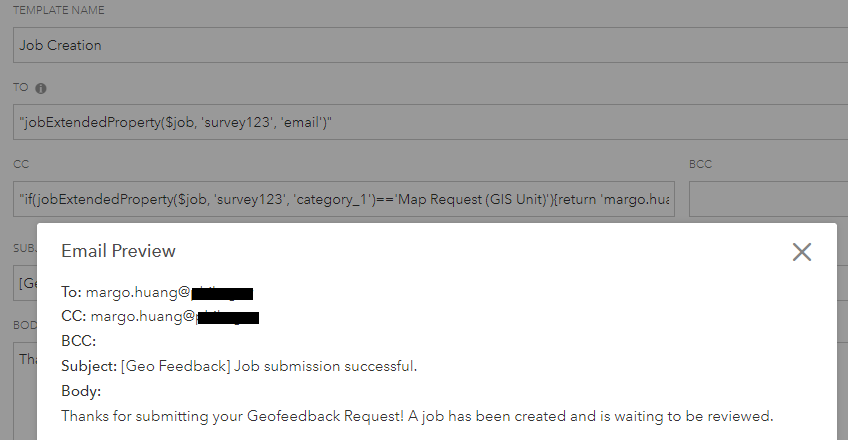

This is what I have for 'TO' line - "jobExtendedProperty($job, 'survey123', 'email')"
This is what I have for 'CC' line - "if(jobExtendedProperty($job, 'survey123', 'category_1')=='Map Request (GIS Unit)'){return '[email protected]'} else if (jobExtendedProperty($job, 'survey123', 'category_1')=='ERV Issue (GIS Unit)'){return '[email protected]'}"
When I do 'preview email', both lines return desired email addresses. However, after I submit a test Survey123 form, no email is sent to me.

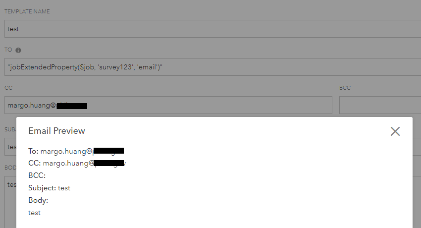

I tried putting my email address under 'CC' line as static value while keeping the arcade function in the 'TO' line(which is supposed to return my email address).
This is the email I got after Survey123 submission. Nothing is in the 'TO' line.

It is confirmed by ESRI staff that Email Template doesn't read extended property tables well. Email Templates are intended for simple messages since it applies to all job templates.
It is recommended to use Send Email step instead since Send Email step is configured specifically for a particular job template.
