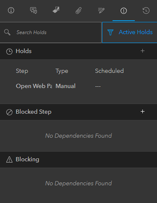

- A manual hold, where you can apply a hold or dependency manually on a step using the job details panel on the Work page. This is exactly as it sounds where you'd manually set and release the hold.JFarmer_0-1707140084437.png

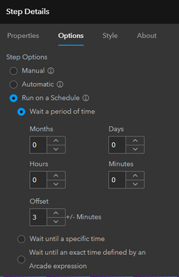

- A scheduled step, where you can schedule a step to be on hold until a desired date / time. This is configured for each step on the diagram where this is desired. (https://enterprise.arcgis.com/en/workflow/latest/help/scheduling-options.htm
With a scheduled step, provided you have the Advanced license, once the hold expires the step will run automatically if it is set to do so. If you have the Standard license, the hold will be released but the step will not run automatically, even if set to do so.
