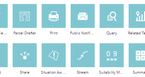

Our team is currently trying to build an application and utilized the smart editor widget, but it appears to be missing.
Is this widget still supported as an out of the box option in webapp builder?SmartEditor.PNG

It is still supported. Can you confirm that it's not already added someplace else in the app, maybe the header bar or a side panel? You can only add a single Smart Editor widget in your app.
- Josh Carlson

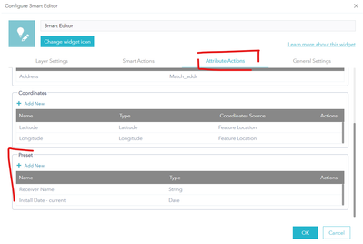

Hi @JoseSanchez ,
Presets are disabled from the Layer Settings and should now be setup from the section in the Attribute Actions tab.
CRHII-NNS
It was in the header bar. Will be deleting this question.
