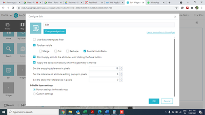

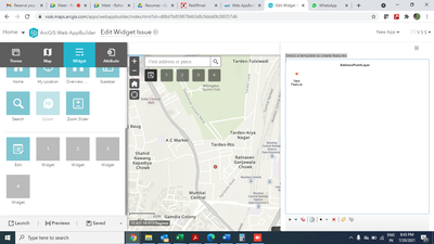

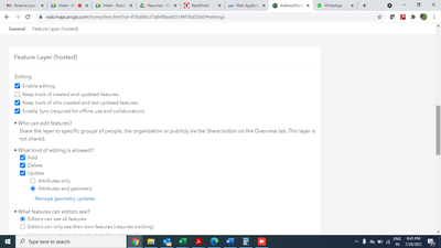

DrVSSKiran
Hi,
Make sure your feature service is the editable mode. And you need to do only few settings in your edit widget tools refer below figure.
1. If not enable in editing mode go the feature layer setting and enable it following options refer screenshot.
2. apply the following setting in edit widget tool
once you have done the following settings,  you click on the edit widget,  and you will see the editable option.
Here is the webapp link: https://vssk.maps.arcgis.com/apps/webappviewer/index.html?id=d88d7b859878463d8c9ddd0b38f257d6
