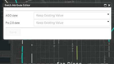

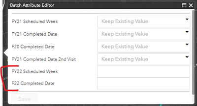

I know this is from 2016, but I appear to be having the same issue as BUG-000097696 still. I cannot edit new date fields when using the Batch editor widget (normal Edit widget works fine, but we need batch). The field is empty and does not accept any input at all.
That being said, older date fields I had, possibly published from Pro a long time ago, do work.
Anyone find a workaround or? Thank you...

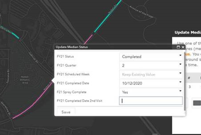

Hi @AlixVezina, I added Previn. I tried creating the date field in both AGO on the feature class directly, as well as in Pro, but same thing.
The most recent date field added in May actually did have this same issue at first, but eventually resolved itself while I was troubleshooting (unfortunately I'm not sure what fixed it at the time). At the time I thought it was a fluke and didn't think much of it. I went back and found a screenshot from the primary user of the app:
