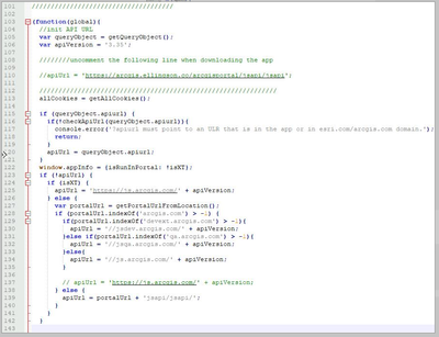

I tried the and found the same thing this morning. Even restarted the entire system and still no changes. Below is what our code looks like if it helps.
I have not tried your second suggestion "If you change this line to apiUrl = 'https://js.arcgis.com/' + apiVersion; then it will work. "  ----  I'm still trying to wrap my head around what this change actually means. It may work but I don't fully understand what I'm changing and if that change has any risk to the way our organization to be set up??

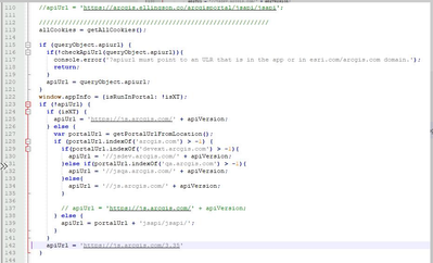

Actually what I did was insert the line after line 141 in your screenshot.  I am still testing here, everything works so far. Changing the version number only does nothing at all because it's line 139 that's firing, generating a URL that looks like "https://YOURSERVER/jsapi/jsapi". So unless you overwrite code on your server nothing changes. When you change it to generate the URL "https://js.arcgis.com/3.35" instead, then (after you clear the cache and reload the page) it will start loading the JavaScript API from Esri's server instead of your own.
Test 1, hit this URL https://js.arcgis.com/3.35 and you should get init.js appearing in your browser. If not then don't change your code.
Test 2, insert the line after line 141, flush cache, reload, if you get errors. remove line.
Tests 3....n, test everything on your web maps that are built using Portal. You are now running a totally different Javascript library. We only use 2 or 3 non-standard widgets and everything so far seems to work fine.

We added the change to line 142, cleared cache and everything at first glance seems to be working now. Thanks for the help!
