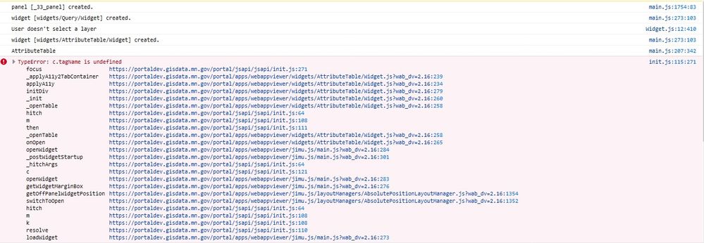

The error in Firefox is similar, but a little different (screenshot follows relevant text):
widget [widgets/Query/Widget] created. main.js:273:103
User doesn't select a layer Widget.js:12:410
widget [widgets/AttributeTable/Widget] created. main.js:273:103
AttributeTable main.js:207:342
TypeError: c.tagName is undefined
Screenshot of text from debugging console in Firefox showing the error (TypeError: c.tagName is undefined [init.js:115:271]); relevant section copied into body text of forum post.Screenshot of text from debugging console in Firefox showing the error (TypeError: c.tagName is undefined [init.js:115:271]); relevant section copied into body text of forum post.
