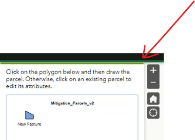

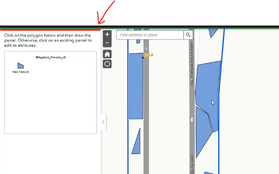

When you click the Attribute Table (or any other widget in your app, actually), the Smart Editor becomes out of focus. You can see this by the red bar at the top of the widget panel. (I know, it's not very intuitive)
If you click the Smart Editor widget panel again, the bar becomes green. If you click the feature to update again, it will be loaded in the attribute inspector.

At the beginning, I click some existing features as it is expected the form opens and allows me to edit the feature attributes if I wish. Then, I close the form. Next, I open and close the AT. Now, when I click on any feature I cannot edit any features. Then I access the code and I comment out the two lines in the _mapClickHandler function function. Save the file and reload the website. I open and close the AT and now I can click on any existing feature and edit its attributes.
