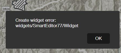

AlainMunyaneza1
Hi Robert,
Hope You are well. We have tried to copy the Smart editor widget as many widgets and replaced all the file names. We still get the error same as Thach got above when you view the widget in web appbuilder. It brings this same error as Thach on pic
