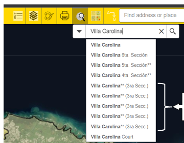

DiegoLlamasOlivares
Hello Robert,
I want to show on display field different result for example this units at what sector belongs so, display two results. I need to use web app builder developer right, this is not out of the box option. ?
Regards,
DLL
