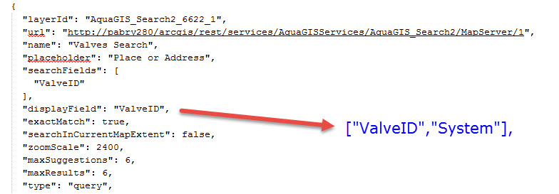

haThach
Thanks, Robert.  I tried your suggestion but it return the same three result. Am I missing something?
      "layerId": "AquaGIS_Search2_6622_1",
      "url": "MyServiceURL",
      "name": "Valves Search",
      "placeholder": "Place or Address",
      "searchFields": [
        "ValveID"
      "displayField": "ValveID",
      "suggestionTemplate": "ID: ${ValveID}, System: ${System}",
      "exactMatch": true,
      "searchInCurrentMapExtent": false,
      "zoomScale": 2400,
      "maxSuggestions": 6,
      "maxResults": 6,
      "type": "query",

haThach
Robert,
Can you clarify this a bit. I'm currently using ArcGIS Server 10.4.1 which should Supports Pagination: true. I did get a suggest of a single field but not double field. Do I needs to add the system field to the property "displayField"?
RobertScheitlin__GISP
MVP Emeritus
Ha,
   No if you read the documentation on the search widget you will see that the displayField can only contain one field name and the suggestionTemplate:
(Added at v. 3.14) A template string used to display multiple fields in a defined order. This only works with feature layer sources and takes precedence over displayField.
