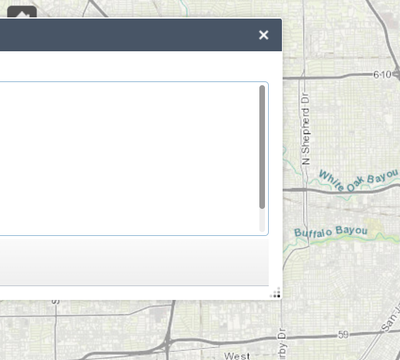

Thank you Robert it worked and able to open widget B from widget A but widget B is going out of map on open how to get widget open in  center of the map. plz help me
RobertScheitlin__GISP
MVP Emeritus
@naveenbesri Here is some code I use to open an off screen widget.
define([
'jimu/WidgetManager',
    'jimu/PanelManager',
    'dojo/_base/array',
function (
WidgetManager, PanelManager, array
postCreate: function () {
this.wManager = WidgetManager.getInstance();
        this.pManager = PanelManager.getInstance();
_openAboutWidget: function () {
        if (this.wManager) {
          var widgetCfg = this._getWidgetConfig('About');
          if (widgetCfg) {
            var aboutWidget = this.wManager.getWidgetByLabel(widgetCfg.label);
            if (aboutWidget) {
              this.wManager.openWidget(aboutWidget);
              this.pManager.showPanel(aboutWidget);
            } else {
              this.wManager.loadWidget(widgetCfg).then(lang.hitch(this, function (widget) {
                if (widget) {
                  this.wManager.openWidget(widget);
                  this.pManager.showPanel(widgetCfg).then(lang.hitch(this, function (panel) {
//Move the widgets position back to on screen
                    panel.setPosition({
                      top: 45,
                      left: 55
                    this.pManager.normalizePanel(panel);
