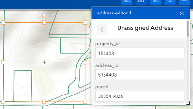

I'm trying to troubleshoot a scenario where the Editor widget will be populated with data, but not open. I'm using the code you posted here.
const action = appActions.openWidget(this.state.editorWidget.id);
console.log(action)
//{type: "OPEN_WIDGET", widgetId: "17919c5e87a-widget-1"}
//type: "OPEN_WIDGET"
//widgetId: "17919c5e87a-widget-1"
//__proto__: Object
getAppStore().dispatch(action);
It appears the widget is getting the message to enter an edit workflow because the fields are correctly populated. This image shows the widget after I open it via click.
@RobertScheitlin__GISP Were you able to use appActions?

PhilLarkin1
Thanks for your help. Using the id generated from props was the key.
