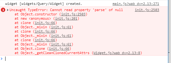

Got a message today
init.js:2503 Uncaught TypeError: Cannot read property 'parse' of null
    at Object.constructor (init.js:2503)
    at new <anonymous> (init.js:201)
    at clone (init.js:66)
    at Object._mixin (init.js:61)
    at Object.clone (init.js:66)
    at Object._getCleanClonedCurrentAttrs (Widget.js?wab_dv=2.13:8)‍‍‍‍‍‍‍‍‍‍‍‍‍‍‍‍‍‍‍‍‍‍‍‍‍‍‍‍‍‍‍‍‍‍‍‍‍‍‍‍‍‍‍‍‍‍‍‍‍‍‍‍‍‍‍
Same in IE
Also other Queries seem to be working in that same widget.  Just this one.  Even when we add a simple 1 field query on this FC it dies.  I can query via the service URL just fine.

Here is the line it is stuck on
this._setSyntaxTree(this.profile.parse(this));this.async=this.async||this.profile.isAsync(this)},hasGeometryOperations:function(){var a=this._traits.geometryOperations;void 0===a&&(a=this._traits.geometryOperations=f.hasGeometryOperations(this.syntaxTree));return a},hasFeatureSetOperations:function(){var a=this._traits.featureSetOperations;void 0===a&&(a=this._traits.featureSetOperations=f.hasFeatureSetOperations(this.syntaxTree));

Ok we may have finally found it.
If there is ANY Arcade expression in the map it breaks.  Even if that Arcade expression is on a different layer than the layer for the query!  That made@ it so hard to find.
Robert Scheitlin, GISP any idea why Arcade breaks the Query widget?  We are using the AGOL builder but same on WAB.
Has anyone used Arcade in a map that uses the Query widget?  Seems like this would have been caught in the past.
